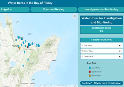

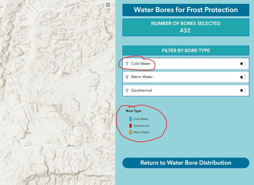

In my current project I would like 20pt to be my minimum font size.
Two items that that I am not able to control the text size of are:
1) The text in the filter widget
2) The category labels in the legend widget
The result being that they look very small in context.
It would also be more visually pleasing to be able display the legend symbology so it looks larger without changing the symbology on the map (I can think of two workarounds: a) a dummy map with large symbology and b) use a snipped image instead of an active legend) - but I'd rather have an active legend widget.

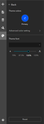

Assuming you don't have developer edition, your best option would be to open up your theme and bump up your font size from there. You may have to adjust some of your other fonts down afterwards.

My screen grab is with the 125% setting - it would be nice to get a higher option.
One I've set a font size, if I adjust this setting it only seems to effect line spacing of the other text - so I'd like to be able to go up to 150% or even 200%.
Here is my work-around where the Legend in an image widget, NOT a legend widget - so I will have to be careful not to change the symbology in the map!
