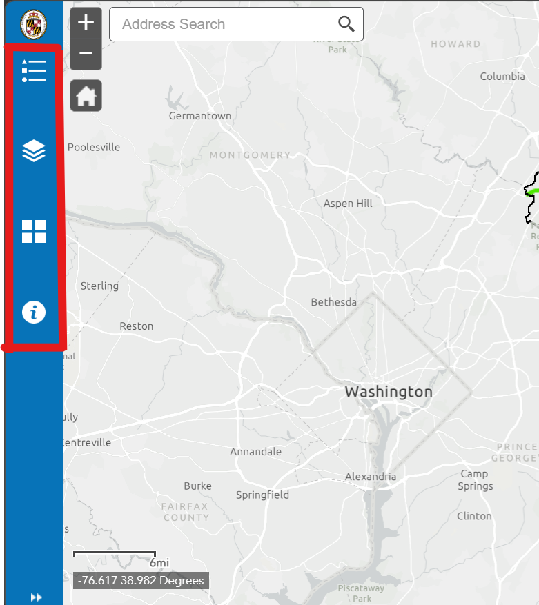

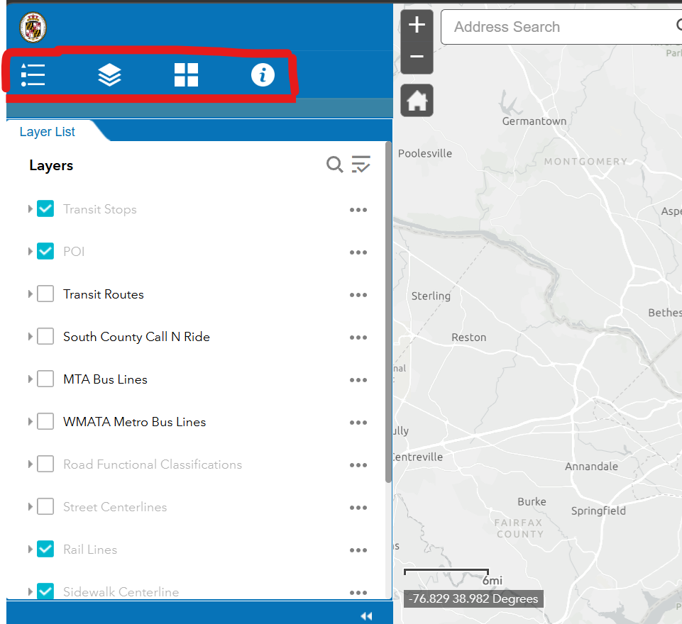

I am trying to make a collapsible panel has widgets in it, and I want those widget buttons to still be visible when the panel is collapsed. And so when you click on a widget icon or text, it will expand the panel again and open the view of the widget you selected.
Widgets when panel is expaneded:
Widgets when panel is collapsed:

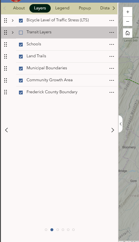

ShengdiZhang
Hi @JamesPoeschel ,
You can refer to the Tab template for a similar effect. However, this is not a perfect solution either.
