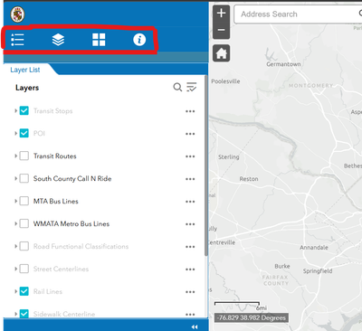

I am trying to make a collapsible panel has widgets in it, and I want those widget buttons to still be visible when the panel is collapsed. And so when you click on a widget icon or text, it will expand the panel again and open the view of the widget you selected.
Widgets when panel is expaneded:

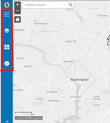

Widgets when panel is collapsed:
Here's the link to the web app builder I'm using as inspiration.
Bicycle, Pedestrian, and Transit Assessment

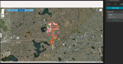

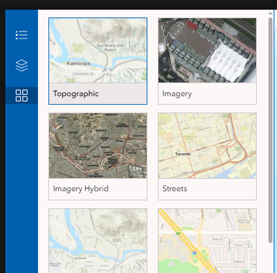

It wouldn't be a perfect recreation, but what you could do is have a Section widget inside your Sidebar, and the Views Navigation (horizontal widget-picker-spoof) outside of it, and kinda use the Style panel to pin it to the top-left or wherever. Then in the Views Navigation Action panel, set up Button Click->Sidebar->Toggle Sidebar. Effectively that gets you everything except the transposing of the widget-picker in your reference app.

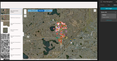

In this example, you could hit 'Basemap' again to close the sidebar (below pic), or change the view to a different widget hidden in the Section-in-Sidebar.
Again, not perfect, but close!

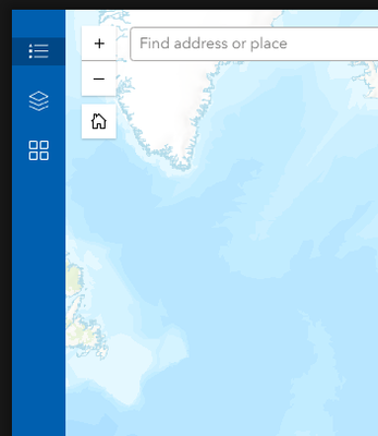

You can refer to the Tab template for a similar effect. However, this is not a perfect solution either.
ShengdiZhang_0-1778143018160.pngShengdiZhang_0-1778143018160.pngShengdiZhang_1-1778143024216.pngShengdiZhang_1-1778143024216.png
