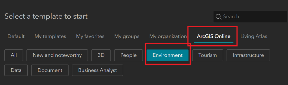

  1. Sign in to ArcGIS Online
  2. Go to ArcGIS Experience Builder
  3. At the top right of the page Create New
  4. Select ArcGIS Online
  5. Select Environment category
  7. Chose one of the template you want
  9. Select the Events and hit up the create button.
  10.  Scroll down and read the Multipages apps
  11. Please read about the Express mode and Full mode before starting yr project, Express mode offers a simplified builder interface, but, if you have switched to Full mode, you cannot get back to Express mode
