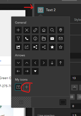

Hi all,
is there any way change a custom icon within the Widget Controller? i checked all of the settings in Experience Builder and don't see a place where i can change or upload a custom icon. please help.
thanks!!
W
JeffreyThompson2
MVP Frequent Contributor
The icon in the settings panel is clickable. Clicking the plus icon allows you to upload a new icon. It is also possible to rename a widget by clicking its name next to the icon.

WilsonLee
oh man!!! i should click every single thing on the screen!
MILLION THANKS!!!!!! 🙏  🙏

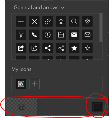

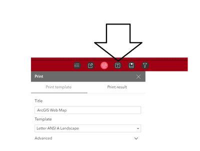

AdamGebhart
@JeffreyThompson2
Do you know where the icons are stored in Developer?  I'm looking and for the life of me don't see any of them.
I posted a question about how to update the widget icon color in the EB interface or through the code and thus far neither seem to be an option.  At this point I'd be happy with making a copy of an existing icon, the filling in the lines with the color(s) I want in Paint.net.  See https://community.esri.com/t5/arcgis-experience-builder-questions/can-the-widget-icon-shapes-color-b...) .  I'm on EB Developer 1.15.

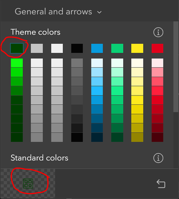

AdamGebhart
Update (all of a couple minutes later)!
You can change the icon shape color like this...
1) Click the widget icon.
2) The icons windows opens.  Look in the bottom left and you will see the icon image.  In the lower right is a color picker.  Click the color picker.
3) I chose my current primary color.  The image in the lower left updates to reflect that color.
4) Close the window.  The widget icon color is now updated to match the background color of my Widget Controller.  Note that this color did not apply to the Map Layers, so that will need to be done separately.
