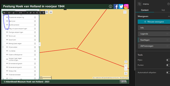

Is it possible to create a custom function that toggles all layers on and off with a single button in ArcGIS Experience Builder?
The reason why I would like to create a custom function to toggle all layers on and off with a single button in ArcGIS Experience Builder. Its is because there are currently around 30 layers on the map that need to be manually toggled on and off. This is a lot of work, and I want to make it much easier by adding a button that can turn everything on or off. However, I am unable to find a function within the button that allows me to add custom commands.
I have created a code for the custom function to toggle all layers on and off, but I am unable to add it to the button:
view.map.layers.forEach(layer => { layer.visible = !layer.visible; });
I hope that you can possibly help me further.. Thank you in advance.
Atlantikwall
Here is an example. We currently have 30 separate layers, but we want to add a button that toggles all layers on and off at once, so that we don't have to do it manually.

Hi @Atlantikwall-Museum
I think a Bookmark widget could be a workaround to achieve what you're after - since layers' visibility will be remembered in a bookmark:
  • Add a Bookmark widget, choose any template and connect it to your map widget
  • Add a new bookmark, choose map layers tool and toggle layers' visibility as your wish, save the bookmark
  • At runtime, you can click on this bookmark to view layers as you set before (you can change extent or add drawings in bookmark as well)

Atlantikwall-Museum
Thanks for the help. The problem is solved and it work as it should be 🙂
