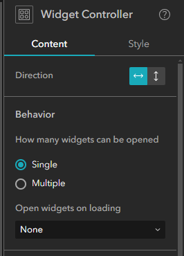

I've been trying to picture this scenario.   I recently had a project where I had a custom widget put into a widget controller, and other widgets would stay open like search for example after the widget loaded from an action.  The one thing I noticed was the widget controller has this 'control' of Single vs multiple widgets opening
The other option could be, to create a custom action that closes the particular widget when another widget gets focused, and then have the action fire from the other widget to auto close the one that stays open.
