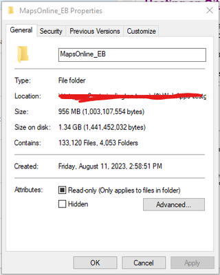

Experience Builder sites get pretty big. My guess is you are over the 1GB limit on GitHub Pages. https://docs.github.com/en/pages/getting-started-with-github-pages/about-github-pages#usage-limits
I just checked the file size on one of my pretty simple single page Experiences and it's over a gig.

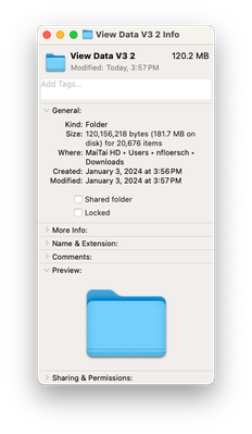

That's a very helpful bit of knowledge to keep in mind and I could see that biting us. However, my XB app folder is only 120 megabytes right now. So I do not think it is size related unless I'm missing something.
