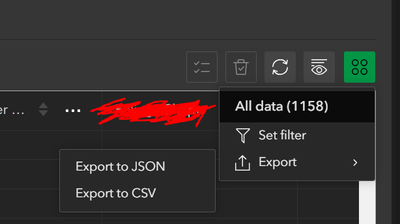

I have discovered that I can no longer export all records from the attribute table to CSV of any of our AGOL hosted feature layers using experience builder. I have a map which contains a hosted layer from Portal which still allows this functionality. I exported a CSV of all records in an AGOL hosted feature layer earlier in the week and it worked fine.
This is a very important part of many of my organisations tasks and I have had to implement a work around on many of our experience builders in the meantime. I have had to add the select tool to all experience builders so that the team can select all records manually at which point, the export to CSV works for selected records.
Is anyone else experiencing this error and do we know if there will be a fix for this?
Thanks
DeannaTeao
Thank you for your reply. It turns out the issue was with browser pop-up settings. Allowing all pop-ups for Experience Builder was the solution 😊
ChristopherCounsell
MVP Frequent Contributor
Not seeing this behavior in spatial or non-spatial tables. ArcGIS Online Experience Builder:
Experience Builder uses the source data settings, which you can then disable.
  • Check the data source for the widgets in Experience builder that it's still on
  • Has anyone disabled the 'export' button on your hosted feature layers, i.e. as part of tidy up.
DeannaTeao
