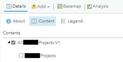

  • I have a web map with a point layer
  • The points are hidden by default (see image below)

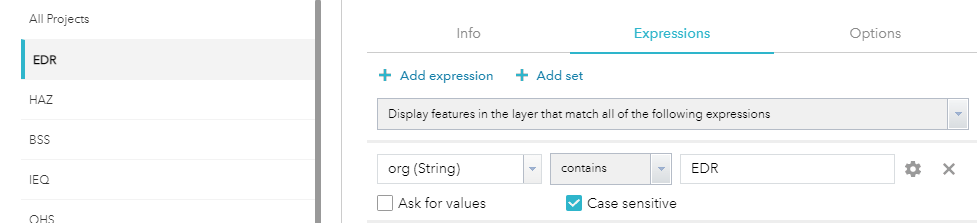

  • In WAB, I have a Filter widget with multiple simple filters (see image below).

  • Same as 1 and 2, but I checked the layer 'on' for the web map.
