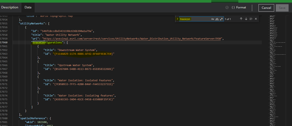

The trace configurations are stored in the web map item. Once the web map is published to your Portal, adding or removing trace configurations to your utility network service will not be reflected in that map.
You will need to make changes to the map itself.
In Enterprise 11.3, open your map in Map Viewer. Go to the Map Properties tab and choose to Configure traces for your Utility Network.
Another option is to edit the web map JSON directly. Login to ArcGIS Assistant, find the web map item and View the item JSON. Open the Data tab and Edit the JSON. Search for traceConfiguration in the code and make changes to the listed trace configurations.
