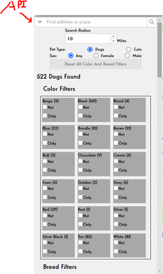

JeffreyThompson2
MVP Frequent Contributor
https://github.com/Esri/arcgis-experience-builder-sdk-resources/tree/master/widgets/js-api-widget
This sample widget shows calling in a Legend Widget from the API. The process is very similar to working directly with the API.
It is possible to integrate an API widget into a larger Experience Builder custom widget. For one application, I found it much easier to call in the API version of the Search Widget as the first part of a more complex search and filter widget, than to try and trigger my custom widget from the default Experience Builder Search Widget.
