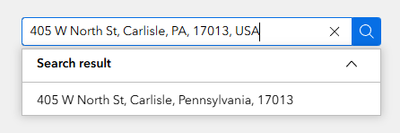

dsinha
Hi @ShengdiZhang ,
You are right about the wording of error message. Here is a screenshot of the sample search input and the error message.

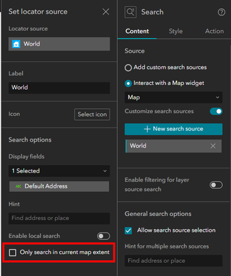

ShengdiZhang
Hi, I tried the locator service and the sample search input you provided, and the search widget works fine on my side:
Could you check the settings for the search widget? Specifically, is "only search in current map extent" checked?
dsinha
Hello @ShengdiZhang,
Did you click on the search result and see if it actually zoomed to the address location? I get the error message when I click on the search result.

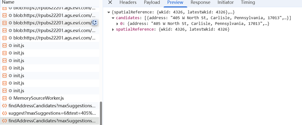

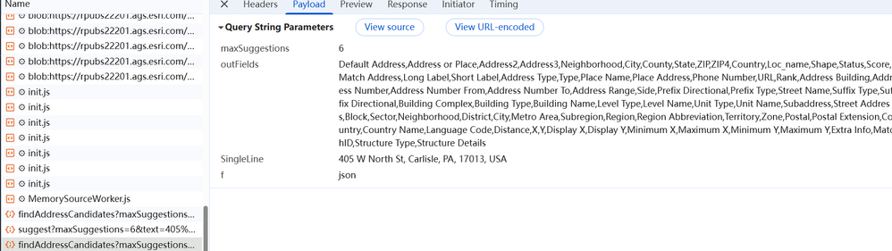

ShengdiZhang

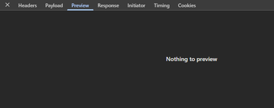

Hi @dsinha , "I tested this in an 11.2 environment, and everything is still working as expected on my side. Could you please check the following requests in the Developer Tools > Network tab?
From my end, they all return the correct values.
Do you see any error messages associated with these two requests on your side?

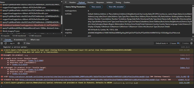

dsinha
Hello @ShengdiZhang
Here are the screenshots with the information you requested.

ShengdiZhang
Hi @dsinha ,
I just tested the app and everything is working fine on our end, as well as for others on the team.
I noticed in your screenshot that the request is timing out. Since it’s working normally for others, it’s likely something specific to your environment — possibly a firewall, proxy, or security setting that's blocking the request.
Other network activity might still work fine, so issues like this can be easy to overlook. If you have any security software or custom network configurations, it’s worth checking if they might be affecting this particular request. You could also try from a different network or device to help narrow it down.
