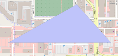

I trimmed it down to a single entry to make it easier to work with, and found that removing the Shape__Area and Shape__Length properties also eliminated the error.
But, the coordinates didn't seem to work, so I substituted some random lat-lon to create a polygon and  the file uploaded successfully:
Very much seems connected to the location data.
