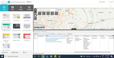

Thanks for your reply, but that doesn't seem to be working for me (see screenshot below).  This is a text field from a hosted FeatureLayer.  Works fine in the popup, just not in the table widget.

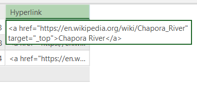

Here is a neat way to do it.
Ensure the Hyperlink (Text) field is long enough to accommodate the URLs along with its formatting elements.
You can format the field like this
<a href="file://filepath" target="_top">hyperlinkname</a>
In my example, it looks like this in ArcGIS Pro
Once published (Shared as web layer), it looks like this, in ArcGIS Online Map Viewer as well as in Experience (Table Widget).
