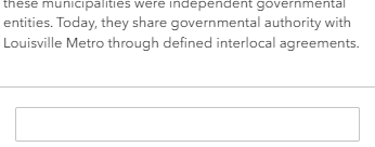

#3: Filtering large amounts of data with user select
The Municipalities feature layer has over 100 municipalities. With the existing app, all municipalities are listed. I recreated this in Experience Builder with another Filter widget, and used the SQL Expression Builder to select 'Ask for values'. However, the values do not appear for municipalities as there appears to be a limit to how many values can exist within feature data. When the limit is met, it just turns into a text field:
Is there a way around this limit? Is this a bug?
