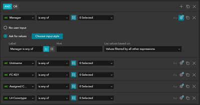

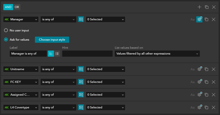

( (Manager is any of (?)) and (Unitname is any of (?)) and (FC KEY is any of (?)) and (Assigned Community Class is any of (?)) and (L4 Covertype is any of (?)) )

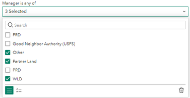

The first filter (Manager) only has 6 options and I am able to select multiple with no issue.

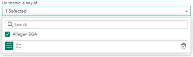

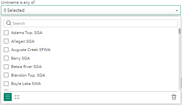

The 4 other filters (Unitname, FC KEY, Assigned Community Class, L4 Covertype) have hundreds or thousands of options and I am not able to select multiple. Once I select one, the entire list disappears.
Is this a loading issue due to the dataset being so large? Or a functionality issue within the widget? I've been unable to find a solution within the filter widget settings or ExB help documentation.

If I were to switch to OR instead of AND then the filter would no longer be hierarchical and function in the way I want it to. Since Good Neighbor Authority Lands is selected all stands within that management area would appear on the map and within my charts/tables. Alternatively, if I were to change ‘if any of’ then select multiple would not be possible.
I believe I do have the expression set up correctly? I want unrelated options to be knocked out as the user works their way down the list of filters. It seems that the ‘list values based on’ setting is processing immediately after each selection, when I wish it was processing after each list of options. Once a manager has been selected or multiple managers, I cannot select more than one options from the lists below although there are multiple options available. The list just disappears too quickly. If I click fast enough I can select two right next to each other, but that just seems wonky…
Try selecting Manager = WLD, and Unitname = Allegan SGA and Betsie River SGA. You can't do it, the list disappears.
