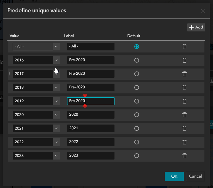

I am building an application that includes a filter based upon a field of years ("2016 through current").  I am trying to group the years for 2016 through 2019 under a single label such that those four years will be selected if the user select that label (such as "Pre-2020").
Using the "Predefined unique values" option in the SQL Expression Builder, I can specify the label for the years 2016, 2017, 2018, and 2019:

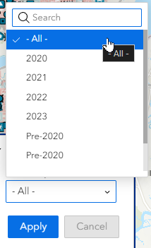

Unfortunately, the Filter Widget does not combine those years into a single option, but instead lists them out individually, with the labels repeated.  And each label still only applies to the respective year to which it is assigned.

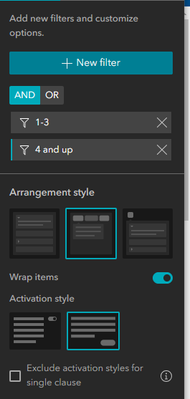

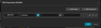

Here I created a single button that will filter values between 1 and 3.
Then I made a new filter and set it to IS predefined unique values for the larger numbers.
This will give me two buttons. One that filters 1-3 and another that triggers a dropdown menu for 4-6.
From design perspective, it would probably be better to make individual buttons for 4,5, and 6. Especially if these individual numbers are supposed to have equal importance as 1-3 as a group.
