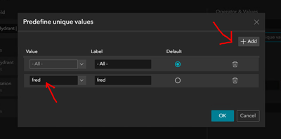

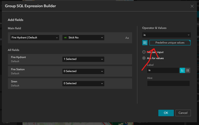

JeffreyThompson2
MVP Frequent Contributor
If you click Predefine Unique Values then Add, you can type into the Value field and create values that are not in the data.

EdmondChan_VK
Oh my god! I didn't know I could type in there! I typed in the search box and thought I won't work!
Thanks so much Jeffrey!
