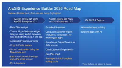

JeffreyThompson2
MVP Frequent Contributor
The next ArcGIS Online update should be sometime this month and it includes a Date Filter Widget. So maybe a built-in solution is coming soon?
https://community.esri.com/t5/arcgis-experience-builder-blog/arcgis-experience-builder-2026-roadmap/...

Teresa_Blader
Well that's exciting! I'm also waiting on the copy and paste so maybe quarter 1 will be a home run for both!

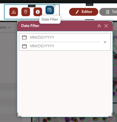

Teresa_Blader
It looks like the new date filter isn't really as expansive but is mostly just a calendar selector. Which is nice, but it didn't expand any of the date options in the current filter, so still no simple way to set up quarter filters. Shucks.
