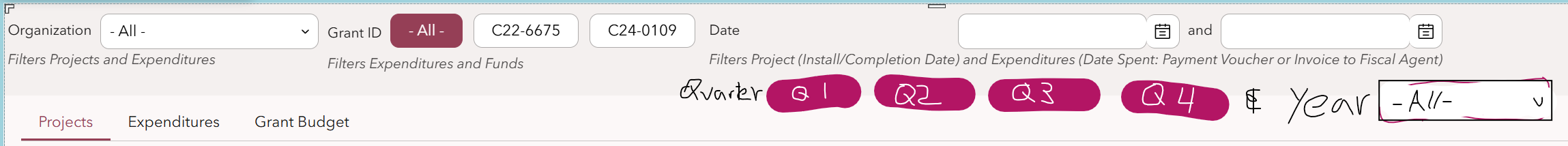

Goal: Group Filter that applies to a date only field in a few tables, where users can pick the quarter and the year
I did this for a summary table with a data expression feature layer in ExB and added Q1, Q2, to fields - but I want to have buttons like this to filter by quarter without doing a data expression. This is the kind of stuff that is SOOO easy in Excel but SO HARD in ArcGIS. 😭
