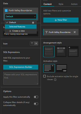

I have a simple web map with one layer (lets say its Roads), which is displayed on three separate pages on my Experience Builder app. On each page, I have a filter setup to display the correct Road by its ID.
The filter works once, on whichever page I load first. Then when changing pages, the filter is turned 'on' by default - but switching it OFF then displays the Road from the previous page - not the road ID listed in the filter, and not the expected behavior of the toggle on/off.

So, when creating the filter, try creating a view for that particular map and call the view that map name, for easy reference, then apply the filer expressions against that view. This means you're not filtering the default data.
Hopefully on the subsequent maps, if you apply same method, you'll not get the cross-filter effect.

Thanks Jonathan. I have tried that method, and still get the same result. Side note - so seems strange where you set a secondary/filtered View, but still require to essentially re-enter the SQL expression again.
