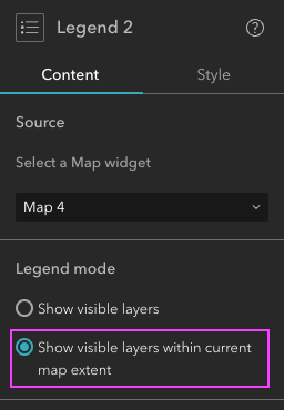

Hi @Charlie_Kaufman, you can now use the new legend mode - Show visible layers within current map extent. It's a new feature just released in the ArcGIS Online release.

Shen- Is this option in the map view or in Web App Builder?  I'm not seeing anything that has that particular "Show visible layers within current map extent" as an option to check.
Shen_Zhang
It's part of the legend widget settings. However, please note that this option works on the layers level, not on the features level. If you have a layer with multiple symbols, all the symbols will display, not just those within the current map extent.
We will add this feature soon.

Is this in Exp Builder?  I know we all need to be migrating over to that, but I have 100s of historical Web Applications and users that are still used to the original Web App builder so I am still fielding lots of questions about the original.    It is nice to know that feature exists in the newer builds.
Shen_Zhang
Yes, it's available since June 2024 Online release (Enterprise 11.4).
