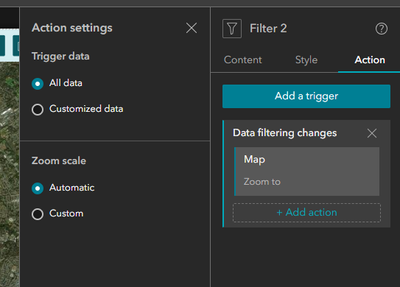

apgis16
I only see the option to select the trigger called "Data filtering changes" and the action be "pan to" or "zoom to"
Laura
by MVP Regular Contributor
Need to use query instead of the filter widget.
