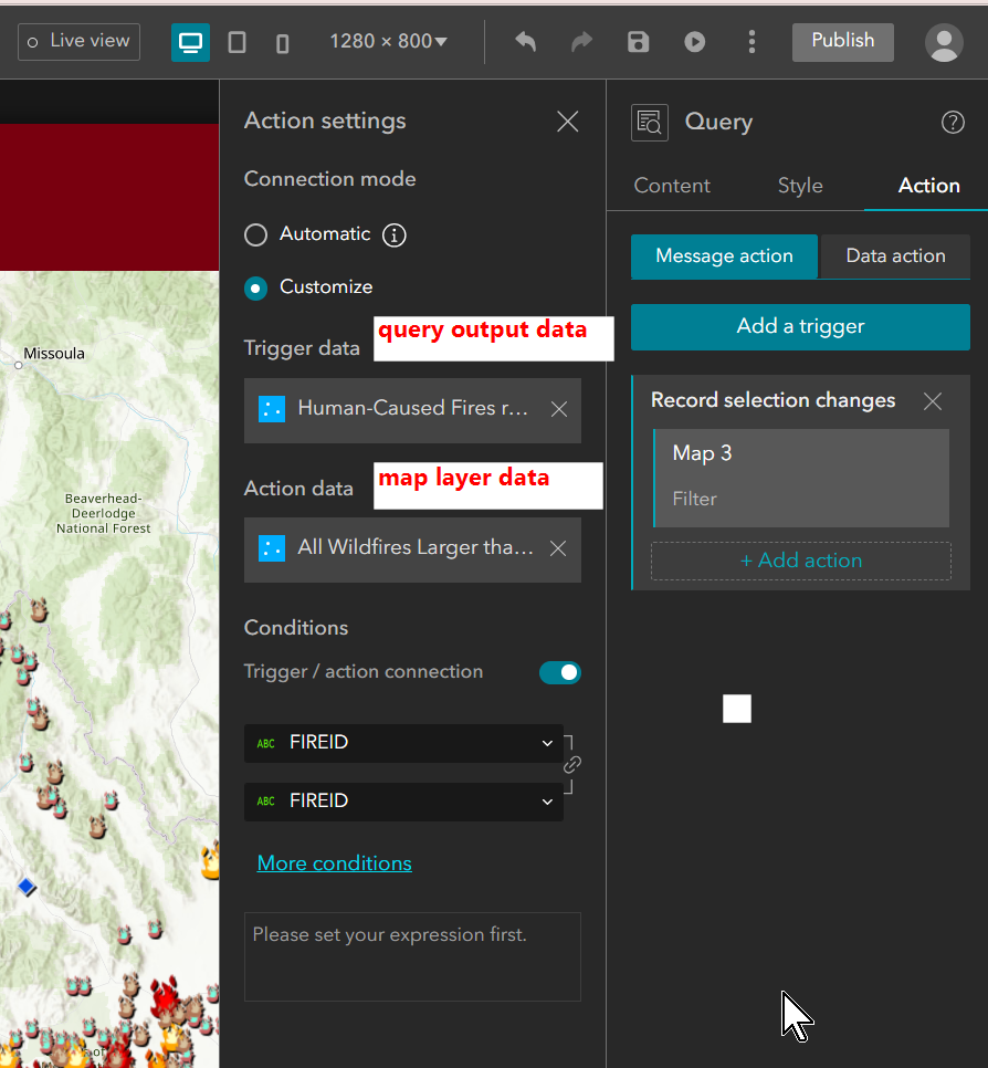

TRIGGER/ACTION CONFIGURATION WITH OUTPUT DATA:

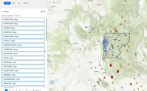

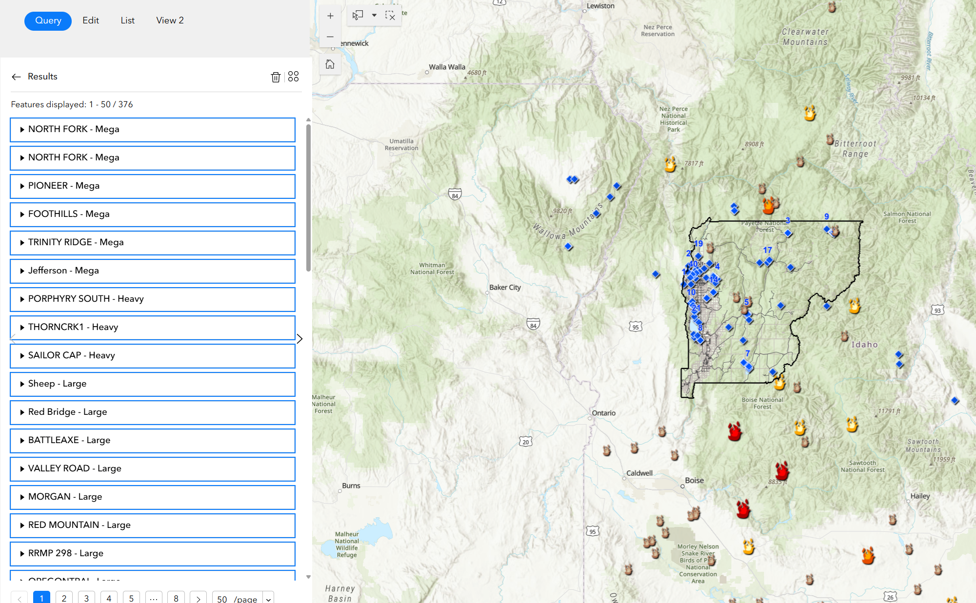

RESULTS FROM QUERY THAT SHOULD FILTER THE MAP BASED ON THE QUERY RESULTS, BUT IS NOT:

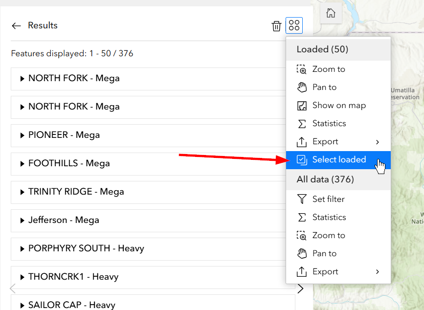

CLICKING ON DATA ACTIONS TO 'SELECT LOADED':

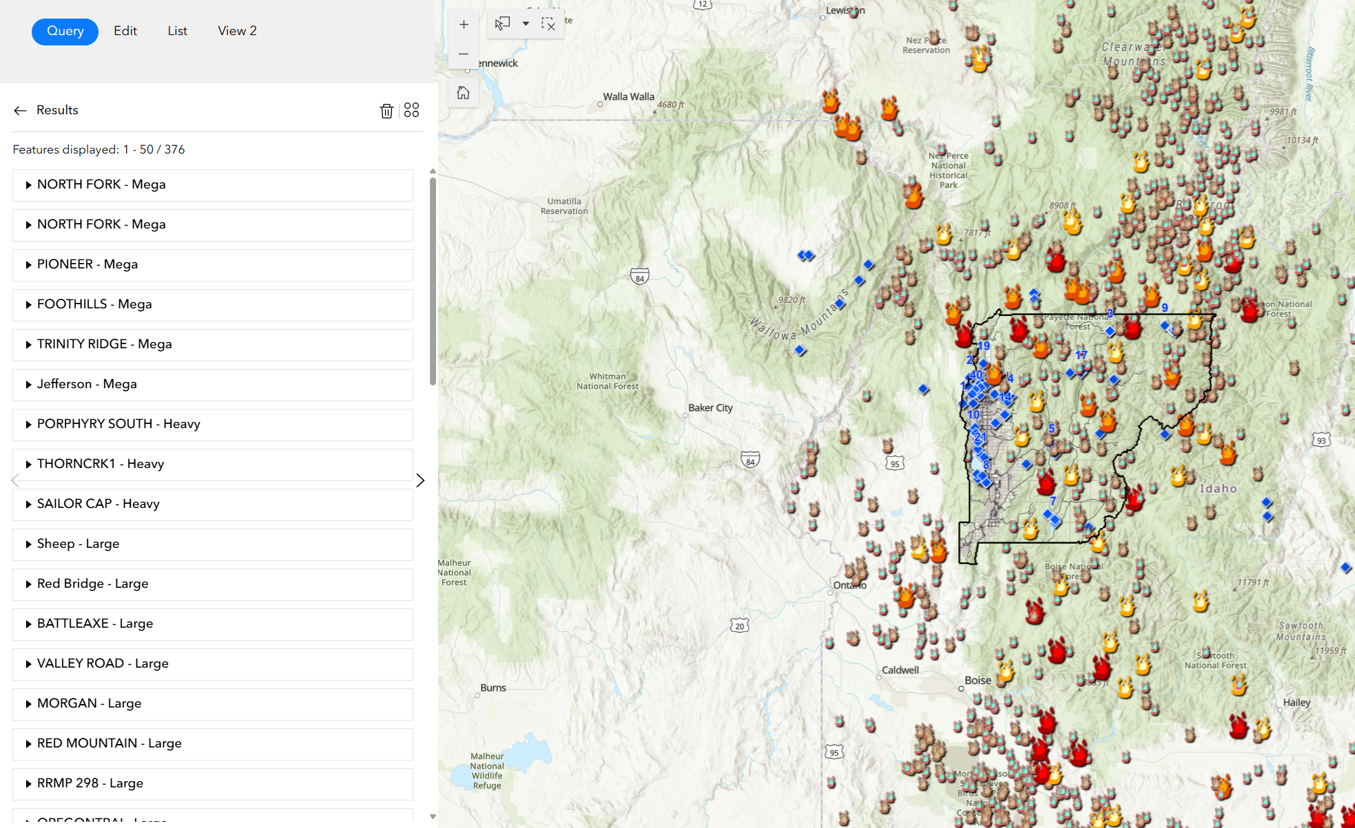

ONCE THE LOADED QUERY RESULTS ARE SELECTED, THE MAP FILTERS:

Thanks for the post! The message you configured is 'record selection changes,' which means the filter action is only triggered when the selection changes. Based on this setup, the behavior you're seeing is expected.

Hi @TianWen the query widget used to view the loaded results as selected automatically. I have been using Experience Builder since its inception and I agree with @SteveMarkovick below - it's a step backwards and too many clicks for an end user to have to 'select loaded' from the data actions menu to have those select or filter in the map.
SteveMarkovick
The "Select Loaded" action feels like a step backward in terms of user experience, especially for applications where the goal is to automate interactions as much as possible. It used to be so smooth having the map filter instantly from query results, and now having to rely on a manual selection step breaks that flow. Really hope Esri addresses this soon, or at least provides a clearer workaround.
