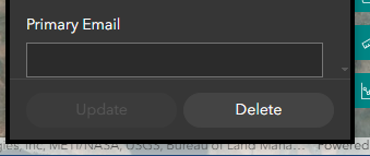

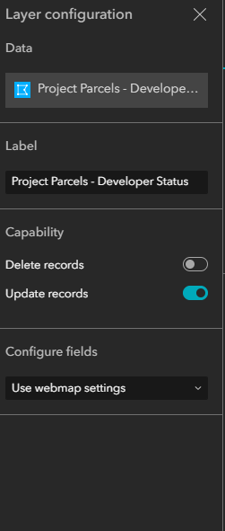

I am customizing the edit widget in Experience Builder within AGOL and disabled delete in the customizations but the delete button is still there in the edit widget. I also shut down delete capabilities for editing at the layer level, but you can still delete data in experience builder. Not sure if this is a known bug or if there is a way to remove the delete feature.

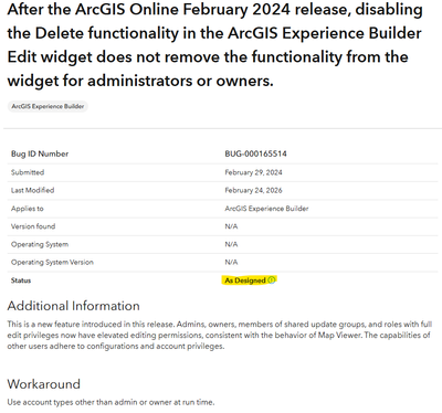

Hello @GeoRenewable , yes this does sound a bit like BUG-000165514.
Synopsis
"... disabling the Delete functionality in the ArcGIS Experience Builder Edit widget does not remove the functionality from the widget for administrators or owners"
Public Explanation
"... Admins, owners, members of shared update groups, and roles with full edit privileges now have elevated editing permissions, consistent with the behavior of Map Viewer. The capabilities of other users adhere to configurations and account privileges."
Workaround
"Use account types other than admin or owner at run time."
Are you using an Admin or Owner account to access the widget ? Does using another account type make the widget behave as you want ?

Bud
Legendary Contributor
For anyone who's wondering, it doesn't look Esri plans to change this behavior:
https://support.esri.com/en-us/bug/after-the-arcgis-online-february-2024-release-disabling-bug-00016...
