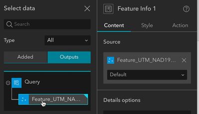

Hello! So I am creating an application using Experience Builder and I want to know if anyone has experience with having the Feature Info widget update when using the Query widget to filter results?
Basically, I want the statistic within the feature info widget to update when I am filtering my data using the query widget. So, say if five points are selected, then the statistic within the feature info widget updates to show "5".

Thanks for your question. Query creates new output so it is not basically 'filtering'.
To achieve FeatureInfo update according to Query widget, you can use Query output as data source of Feature Info widget.

rmacn
Perfect, that worked! Thank you!
