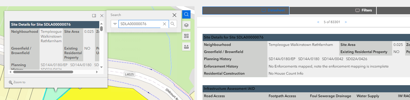

I'm using arcade expressions to populate a complex popup lots of HTML involved to create a tall and wide table, hence the fact I am using the feature info widget to display it, I am supposed to be matching corporate colours. when viewed in the popup it works grand I can have a white text on a dark background but when it populates in the feature info widget the colour changes. Screen grab below gives a good idea of what is happening.
If anyone has any suggestions or has encountered this before I would be grateful if they could put me on the right track.

Hi @LarryMcEvoy70 ,
Thanks for your feedback. This is because ExB overwrite the theme I think, which is bug here for the cutom HTML styles. Would you be able to share the arcade expression so we can take a further look?

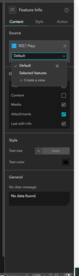

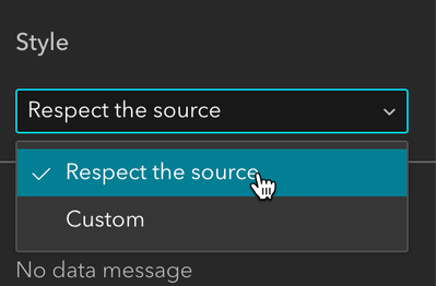

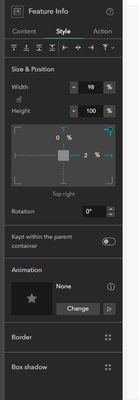

@LarryMcEvoy70  could you confirm if you are choose "Respect the source" option in FeatureInfo setting?
LarryMcEvoy70
Hi Wei,
I have read about this setting but I don't appear to have this setting, I assume it should be in the style tab or the content tab neither appears to have it.
