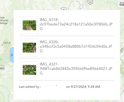

Hello,
I'm making an experience to review records, and I have it set up so that when you click on a record in the table, images attached to the Survey123 record pop up in a Feature Info Box (which is nested in a sidebar). I previously had it so that it displays a single large image with a scroll bar to see the others, but I had a source layer get corrupted and now I can't figure out how I achieved those settings. Now, it displays three small thumbnails in a column. I feel like I've clicked everywhere but can't get the look to match what I had before.

nf3
How specifically do I change the settings? I can't figure it out. I want it to be so the image name isn't shown and the image takes up the majority of the space.

nf3
Oh gosh, that fixed it, but it's so confusing. I thought you meant map viewer WITHIN the experience. That language should be made much clearer within the Feature Info Widget page.
