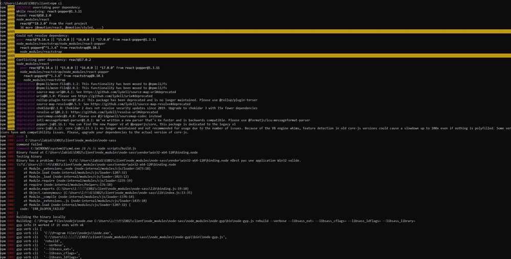

Hello,
i'm trying to install the Arcgis experience builder for developers Edition and it doesn't want :). I have followed this link http://www.davidapps.net/exb/EXBDevTutorial/overview.htm?ms=EgAQEg%3D%3D&st=MA%3D%3D&sct=MA%3D%3D&mw... it's ok for the server but the client not.
I get messages with node or python Errors and I don't where it comes.
So if someone could help me 🙂

You aren't the only one having this problem. Please contact ESRI support and tell them that there is a dependency issue in their node packages. No one will be able to install Developer Edition until they issue a patch that resolves this problem. @AzizaParveen1 @Jianxia @TonghuiMing

@JeffreyThompson2 It seems to be a node-sass installation issue in the environment where the installation happened. We will log an issue to document it.

Hello @JeffreyThompson2 , I resolved the problem with my IT. We have downloaded node.js 18, install Visual Studio, reinstall Python, and it works. I can't explain, i don't understand at all but it works 🙂

Another user with this problem. And at the same time, I was installing Experience Builder for a client and also hit this error. I was able to resolve it for my client by uninstalling Node 20.1 and installing Node 18.16.

Thanks a lot for the advice on downgrading to Node 18.16. I have now ExB 1.13 finally working!
