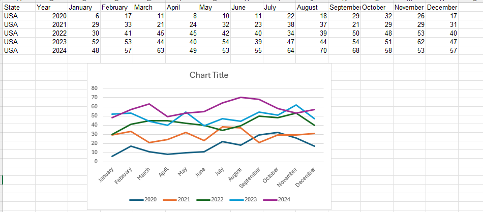

When you create a Chart and Group by a field (such as Year), the Chart is locked to have the Year as the x-axis. I would like to have a layer with twelve fields for a metric per month in that year, and visualise a chart like the following:
Is this possible?

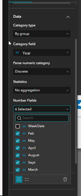

Hi @AustroadsIT ,
I think you can config line chart like this
