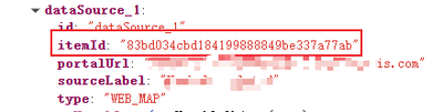

When I have to delete the feature layer view from ArcOnline, recreate it...
 Try overwrite the feature layer but not delete an recreate a new one?
This keeps the same itemId in the data source, and you don't need to re-link it again.
