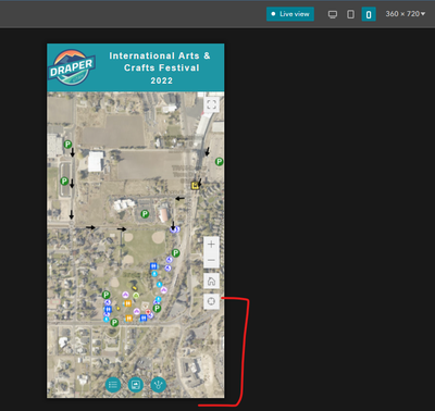

AlixVezina
@BethAnnWinebarger Thanks for the link.
Do you notice how there seems to be a space here and the map tools are shifted up in the Live View compared to in design mode?
This is an issue I've seen now and then, I'll see if there's a way this can get fixed for the future.
The only workaround I see so far is to either move the controller outside of the map and place it below it, or place it in the footer.
