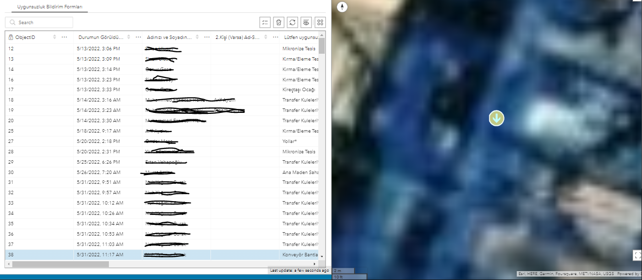

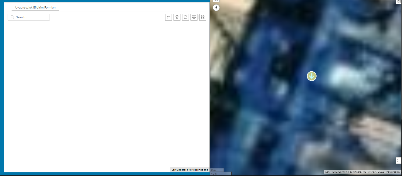

Hi all,
I have an issue with table widget in Exp.Builder. There are some survey data in my table. It is updating so much so fast, refreshing the page constantly and because of that I cant edit or examine my data from it. Is refresh interval could be changed? I use my map in other pages so I'd like to keep the interval same if the problem causing from the map.
Is there any other solution?
  Thanks in advance,
öznur
