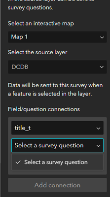

KeithGerhartz1
I am able to get it to work if I create a new survey from scratch. However, the ability to create field connections is not available when using an already existing feature service to store survey results.
ChrisRoberts2
Hi Keith
I have just started to look at experience builder myself and noticed the same thing that I cant seem to make a field connection to an existing survey.  The dropdown list is empty.  did you ever find a resolution to this?

KeithGerhartz1
Just downloaded 1.3 and the same problem exists. Very frustrating.

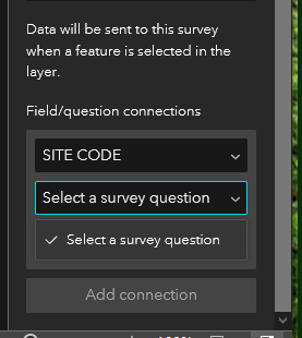

BrittanyBurson
I seem to be seeing the same issue when choosing the option to create a new survey within the Widget. I tried maps with a range of data types, including ArcGIS Server rest services + hosted feature services in our Portal, both polygons and points, but same thing. I can select the field from the layer, but not the linked survey question to populate. This is Enterprise 10.8.1.
@KeithGerhartz1 would you mind sharing at what version you were successful when creating a new survey? Thank you!
BrittanyBurson
Here seeing the exact same behavior. Experience Builder in Enterprise 10.8.1, attempting to use an existing Survey published via Connect.
Are there any workarounds or existing bugs to track, Experience Builder team?

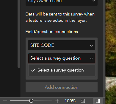

ZhifangWang
Hi @BrittanyBurson ,
Can you please share with us a portion of your XLSForm that can reproduce the issue in Experience Builder?
We can get more detailed info once we can reproduce the issue.

BrittanyBurson
Thank you @ZhifangWang, I have attached the form here. It's linked to a existing FC table within our Enterprise Portal 10.8.1. Published using 3.12 version of Connect.
For now I am using a URL parameter to populate the site code, but it would be nice if it could exist within the Experience instead of a separate window.
Thanks as always for your help!
