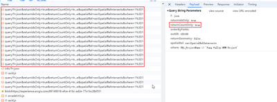

Allen_Zhang
I found a possible reason. There are many queries of returnCountOnly that may stuck the Map Layers widget in your app. @HeatherBell  @TonghuiMing
