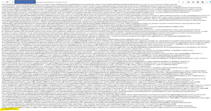

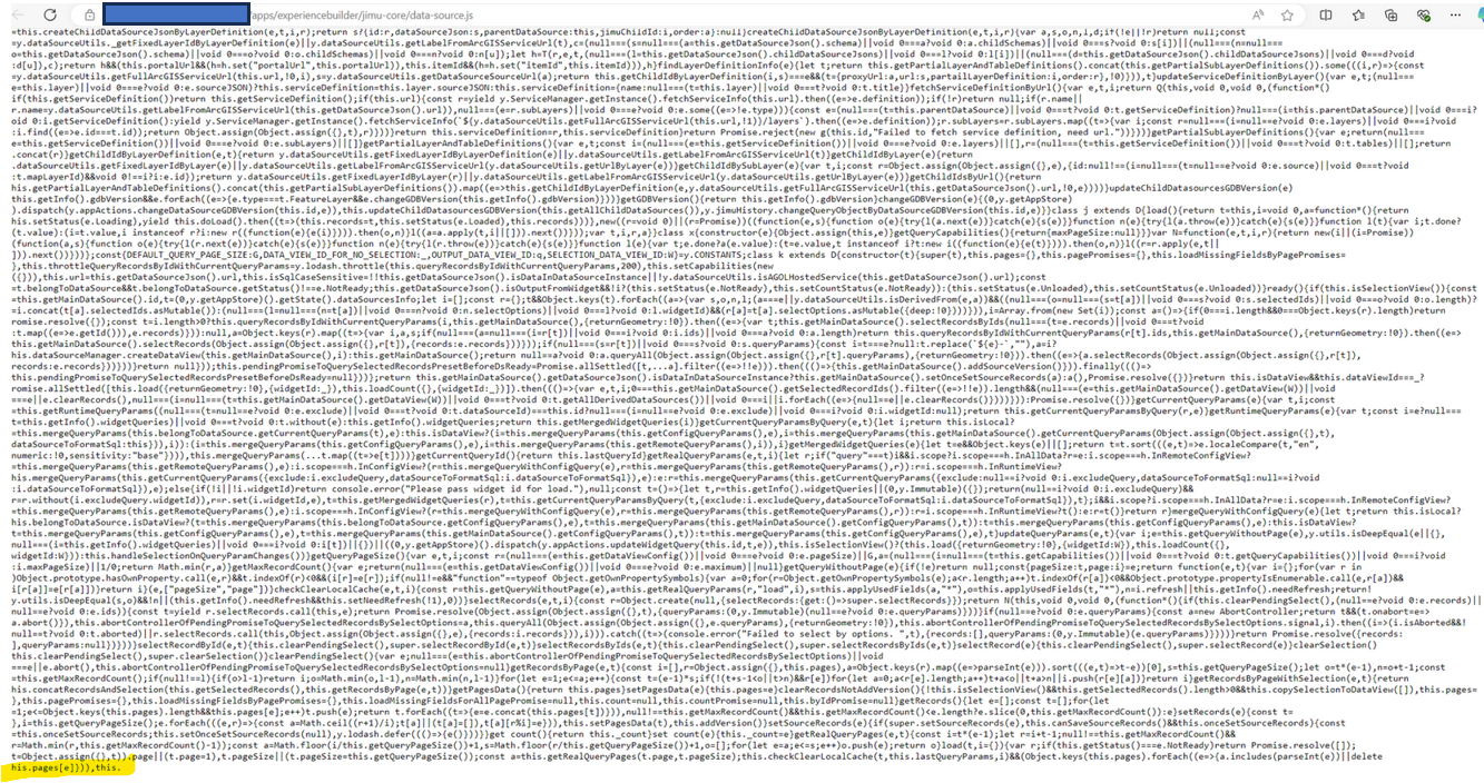

When debbuging I see the following (200 OK from service worker) :
Trying to display the file, it is truncated (check the very bottom of data-source.js)
This is very problematic because clearing the cache does not solve the issue. You have to manually unregister the experience builder service worker to fix this issue.
