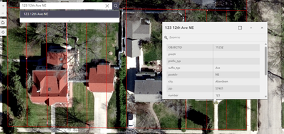

Even with the standard ArcGIS Locator in WAB, the search widget will show this. Is there a workaround to configure this in experience builder?

Hi @EricPescatore, based on my testing (as of today), the current behavior is that the search widget can zoom and pan and select the feature that is searched in the Search Widget but a pop-up will not activate. Yes, unfortunate, but at least it is an enhancement request.

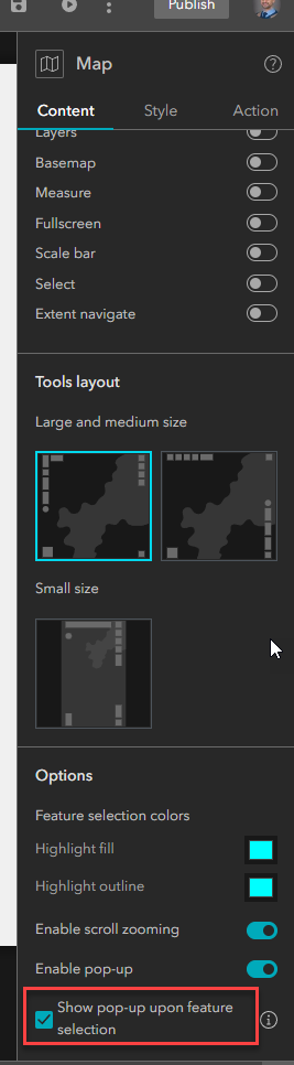

FYI to all, the functionality to open a popup on search results (or from any widget-initiated selection: query, list, etc.) was included with the last AGOL update. It's a setting in the Map widget ("Show popup upon feature selection"). However, there's a bug that causes the popup to be blank if the feature service was published from Pro (instead of directly in AGOL): BUG-000162942 for ArcGIS Experience Builder (esri.com)

The popup, there it was under the Map Widget options. I had not at all considered that was were the setting would be to define how/when pop-up interacted with the map.
For those wondering: Now search will trigger a pop-up. use actions on the Search widget to further refine how it interacts. Again this may not answer the original question of this post but it got me past this step. Thanks Community.
Not where i expected it to be...Not where i expected it to be...

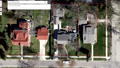

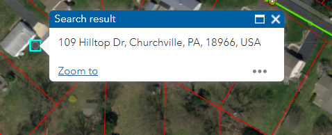

I see that the bug has been fixed (BUG-000162942 for ArcGIS Experience Builder (esri.com)). However, my searches still won't generate an automatic pop-up for me. I have to click on the address bar below the search bar to generate a pop-up. Can you confirm if it works for you or if this is the fix? Thanks for any help you can provide.
