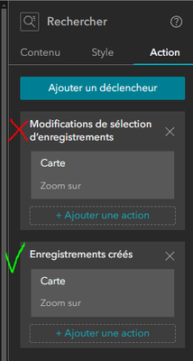

Hello,
I managed to make the "zoom to" work with the "search" widget using the trigger "Created records" instead of "Modified records". See below.
(sorry it's in french)
JasminePrater
I was unable to get it to zoom using when Record Selection Changes, but did get it to work with your suggestion of using when Record Created.  I think they need to tweak this to function better and/or be more clear.

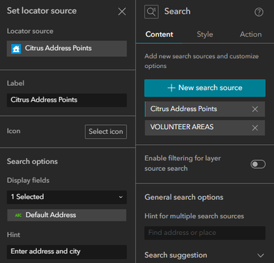

CynthiaSkelhorn
I was also experiencing this issue.  The steps I followed to enable the Record Selection Changes were:
1. Under Content, Add Search Sources (layers in the map that we wished to search, or locators).  In our case, I added one locator for Address Points and one layer for volunteer areas.
2. Under Action, I selected Add a Trigger - Record Selection Changes
3. Under Record Selection Changes, I selected Add Action - Map - Zoom To and then selected either the layer or the locator that I had added in Step 1 for Search Sources.
You can then select multiple search sources for the same trigger.
Save, test with Live View and then publish if working as expected.
