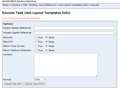

The issue is when we provide it with a service URL for a print service that has 13 templates available within it. We are seeing timeout errors in server and browser tools, images are attached.
Can anyone confirm if there is a limit or cap as to how many templates a service can have when being accessed by the experience builder print widget? The service with 13 templates works with zero errors when utitlised as the service for web map or web applications.

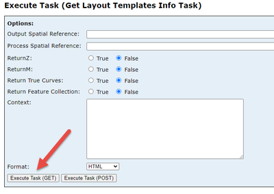

Can you help to check if this problem lies in the service itself? Open the URL in your screenshot, click on Execute Task and see if the operation can be executed without errors.

After following your advice I can see that we are in fact getting an error with the Get Template:
I am unsure what is causing this as the service is published from Pro in exactly the same way as our services that do function with the print widget.
Also as mentioned before that service works when used with Web App builder or when set as the default service in portal to be used by Map viewer....
