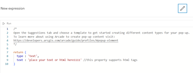

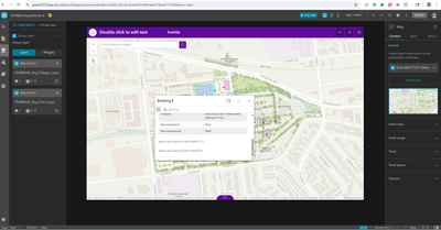

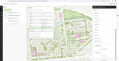

Hi @TimothyRudzik,
Thanks for reaching out. But I couldn't reproduce it. Am I missing something?
MV:
Exb:
Thanks,
Ke
