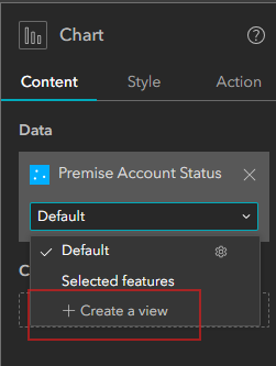

When configuring the data source for the chart, click the drop-down for the layer and then Create a view:
This will allow you to add a filter to the data, and then use the filtered data as the source for the chart.
