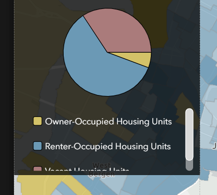

To get familiar with Experience Builder, I'm following along with this tutorial: https://learn.arcgis.com/en/projects/get-started-with-arcgis-experience-builder/
When adding the pie chart with a legend, the legend items do not all appear - a scroll bar is automatically included. There are only 3 legend items, so I thought surely there must be a way to make them all be visible without a scroll bar. However, after messing with the chart widget size and other settings, I cannot find a way to get all of these elements visible without a scroll bar. Has anyone else dealt with this issue and found a solution? Or perhaps am I missing a setting option somewhere?

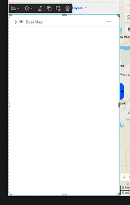

ChenChen4
Thanks for the suggestion. I tried resize but it does not seems to expand the space for the legend area:

I had the exact same problem on the same tutorial. I managed to get rid of the scrollbar by changing the legend font away from Avenir Next, in Appearance -> Text Settings -> Legend Label. Maybe not the most elegant solution, but it seemed to work for me.

JosephKinyon
This was the only solution I could find also, the are no properties to manage the legend dimensions and using avenir at 14 pt meant auto, stretch, nor custom worked--always resulted in a scroll bar.
