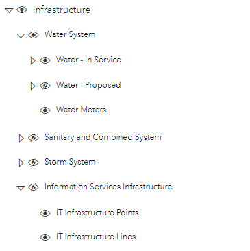

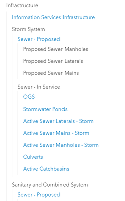

I've brought in a map from Enterprise into experience builder but I'm having issues getting the layers to work properly. All of the features render when I preview the experience, however some of the layers are not selectable. i.e. the features show up but I can't us the selection tool on them. These same layers are causing issues with the table widget — when I go to select data for a new sheet they don't appear in the drop down. In fact, whole groups don't appear.
Are there limitations on what types of layers / groups experience builder can handle?
For instance, the Infrastructure group has subgroups and many layers in it. But only a couple show up to add to the table widget.

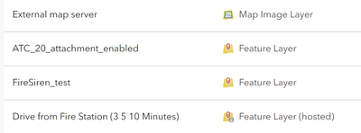

There are many different types of layers but two of the big categories are Map Image Layers and Feature Layers. Both will display fine in Experience Builder but for most interactivity you will need to use a Feature Layer. The easiest way to check is to go into your Enterprise and look at what kind of layer you are using.
GIS Developer
City of Arlington, Texas
RyShissler_Welland
Thanks Jeffrey. They're all feature layers. I was able to pull in an old map that uses the same layers but didn't have them organized into groups and they layers seem to work there. Not sure what happened in the transition to the new groupings.
Works:
Doesn't work:
