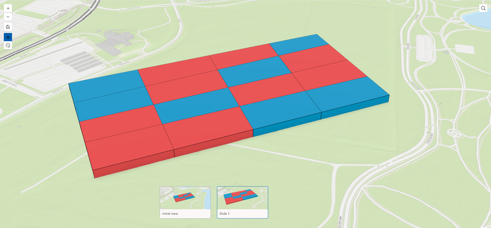

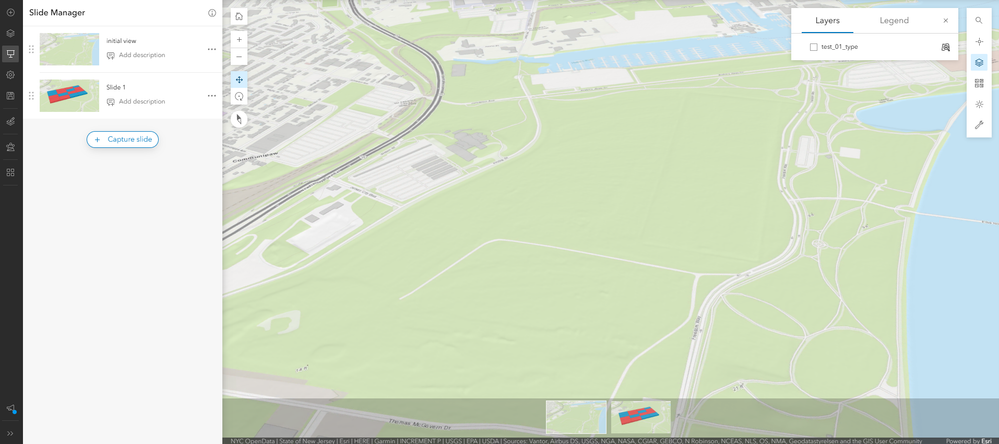

thanks for replying @StephanieW . here is a step by step reproduction I just made:

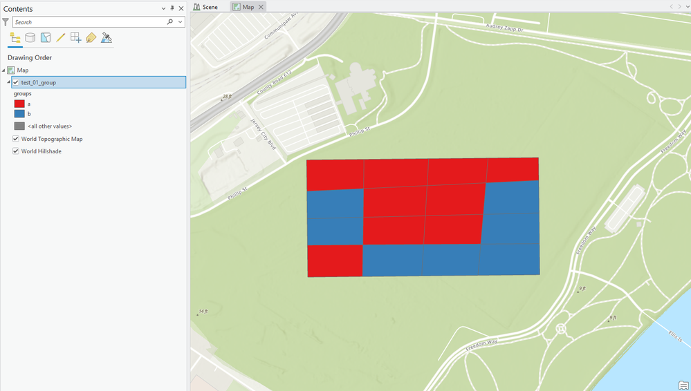

image 1: gispro - polygon layer colored by "type" field.

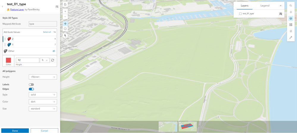

image 2: agol scene - layer brought in
image 3: agol scene: layer stylized by "type" field and shown in style 3d
slides:
'initial slide': layer is turned off
'slide 1' layer is turned on

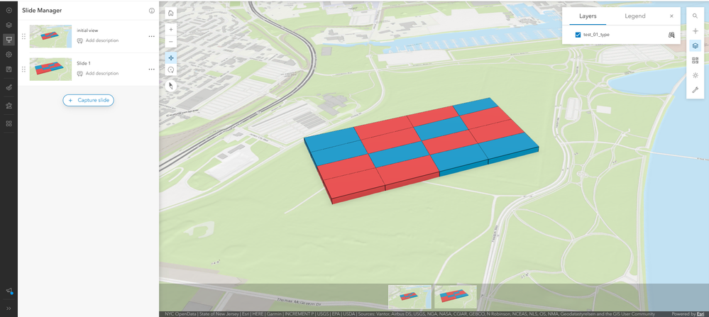

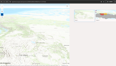

image 4: agol experience builder:
initial view slide: ok

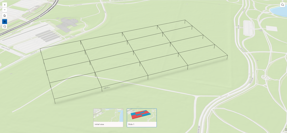

image 5: agol experience builder:
'slide 1': no symbology, only edges, doesn't work!

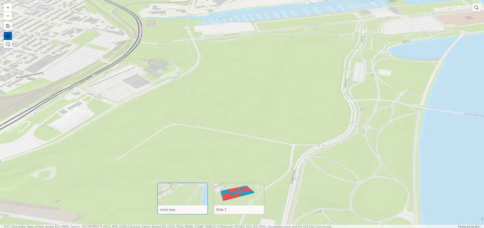

image 6: agol scene:
slides:
'initial slide': layer is turned on
image 7: agol experience builder:
'slide 1': works fine!
I hope that helps!

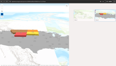

absolutely @Ke_Xu , here you go:
https://experience.arcgis.com/experience/8f3e3ca3dde14358aa5b302f3f3bcf5f
Thanks for looking into it, I really appreciate it!
