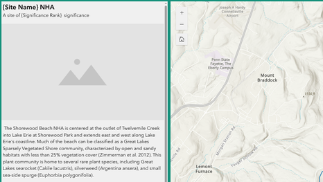

I am building an ExB app that allows users to browse a map, click site features, and return site descriptions and data about the site. I've tried a lot of different options for formatting the site descriptions which I'd like to include the site name, attachment photo, and text, but nothing has gotten me quite what I want.

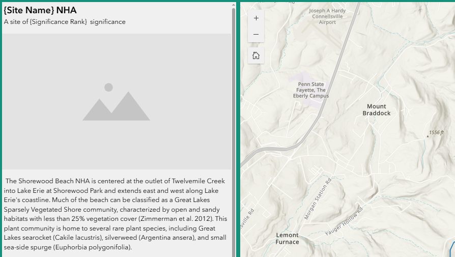

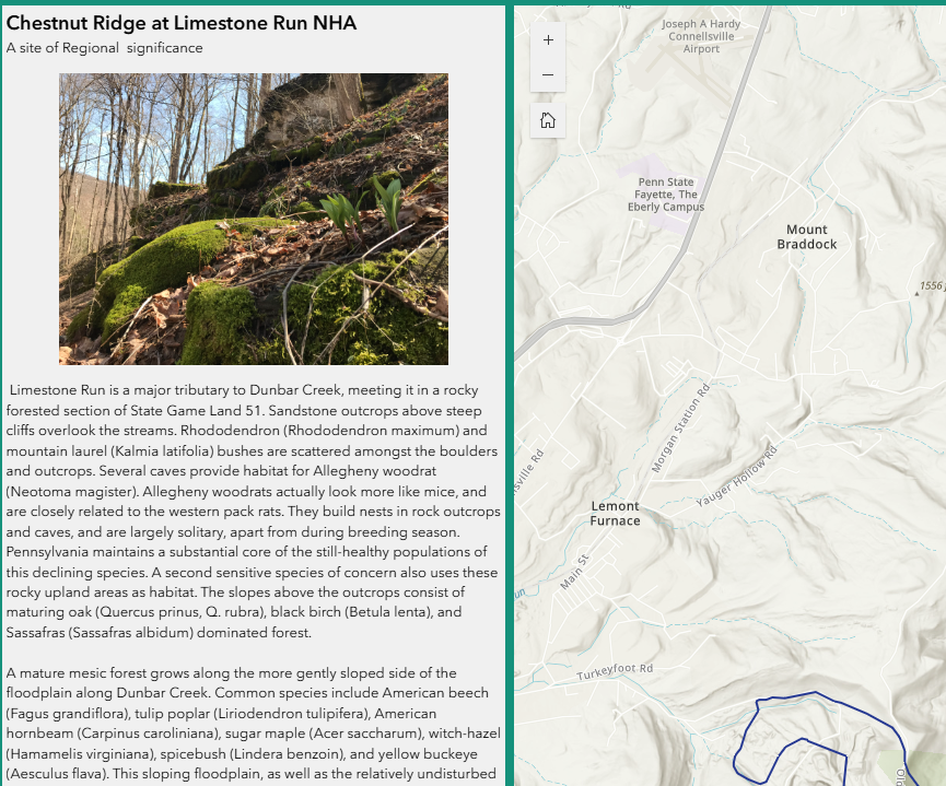

Option 1. I tried setting everything up in a column widget because I like that you can auto stretch text for larger blocks. I like what this looks like format-wise, BUT when there is not a selected feature, I don't want the user to see the back end blank place-holders. Here are the two side-by-side with selection and without selection:
I tried putting the column in a section and changing views when a selection occurred which worked great, but then I couldn't figure out how to change back to the blank view when a selection was cleared.
