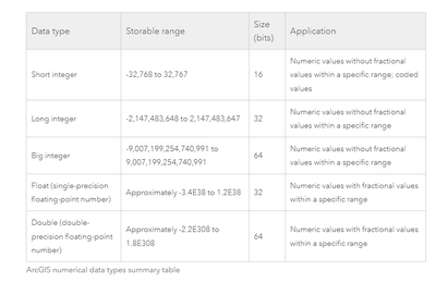

You are exceeding the limit for a Short Integer. I don't know if this matters at all, especially since you are well within the size limit for a JavaScript Number.
