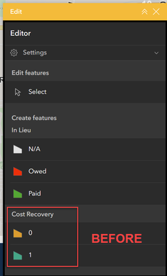

Hi,
What determines if the label/domain shows in the table/edit widgets in EB? We have a few apps set up and some tables show the labels and others show the code.
In the edit widget, for editing records the widget shows the label which is great, but if you select a value, an error message, "Value should be one of the listed values." shows and you can't edit? This is probably related to the text label not being an integer value for the field.

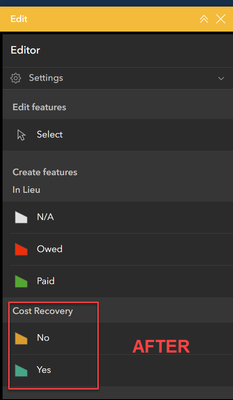

I had this same issue and we found a way to fix it!
From ArcGIS Pro, select the layer, Edit tab-->Manage Templates (Manage Edits section)
Double-click one of the symbols in the Manage Templates pane to open the Template Properties for that symbol, make any change to the Name-->OK-->change the Name back to how you want it to display-->republish service (Overwrite)
After doing this, my Edit Widget symbols were updated with the coded domain description and not the individual integer values.
HannahLegacy1
This worked!! Thank you so much.
