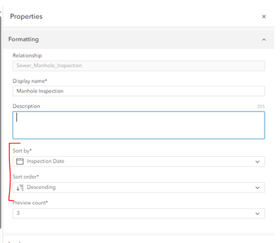

For the sorting, you should be able to configure it in the Form when you add the relationship.

Set the Title of the related record for easy record identification for the user.
You can set the title of the Related Records element from Smart Forms Display Name. Same location as for setting the Sort I have described here Re: Experience Builder - Edit Widget - Record Titl... - Esri Community
And the title of each  record uses the name of the related layer or table automatically.
When selecting a related record to edit, The Edit Widget does not have scrolling activated. This hides related records making them unable to be accessed by the user.
I'd recommend touching base with Esri Support for this one.
I am unable to sort the related records table within the Edit Widget. I would like to sort by the Inspection Date field to show recent inspections at the top of the related records.
This needs to be done in the Map Viewer Forms, not in Experience Builder. See steps recommended here: Re: Experience Builder - Edit Widget - Record Titl... - Esri Community
