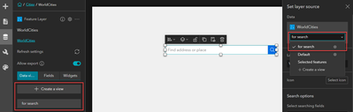

Hi again, aside from the new issue above, there is another issue with the newest updates to Experience builder - I have searches configured in the search widget and the only action I have them associated with is to ZOOM to a feature in the map - but the search is automatically filtering the map view by the feature that was searched and chosen. In other words, it's hiding all other features around the selected one from the search and this is not what I configured - it is not what we want.  This will confuse my users, they won't understand why this is suddenly happening.
I really am trying to migrate my users to EB but things like this make it hard for me to get people on board with the change.
ShengdiZhang
Hi, this is a designed behavior since the Experience builder is data-centric. If you don't want to filter the map viewer during search, you can create a data view and use it in the search source.
Shengdi
KaraUtter
Hi, there is a way for us to configure the filtering of a map through the actions of the search widget, this way we can choose to have the map filter or not filter. That is the way it should be. If EB is supposed to eventually take the place of WAB, then it needs to be more versatile in the types of settings we can configure and the styles of use that we can design. Not all users are going to care about filtering data cards by something they have searched. And if they are going to care, then as their GIS Professional, I can configure that for them in the actions settings for the widget. This should not be forced.
